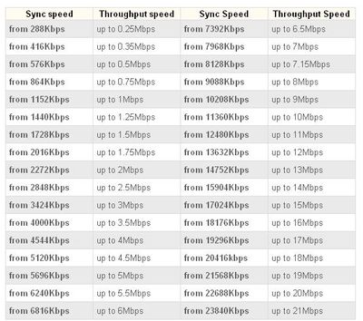

The synchronisation (sync) speed is the speed at which your broadband modem or router communicates with the BT Exchange. This is always higher than the speed at which data will actually be downloaded over the connection. The sync rate is worked out by your phone line's characteristics, such as line length and quality. The shorter the line and the better the quality the faster the line will sync. From the test results you supplied it looks like your Sync Rate is 7616 Kbps, so this is the speed that your router and exchange are talking to each other and unfortunately not the download speed you would achieve.
The BRAS profile is responsible for regulating the maximum throughput (data rate) you will receive on your broadband service. Your BRAS profile changes when a stable connection has been made for a period of time; this may be up to 3 days in some cases. The BRAS Profile will also drop should the line rate decrease significantly. From your results, your BRAS Profile is set to 6500 Kbps, so this is the absolute maximum speed you would get on the line at that point, please don’t confuse this with a fixed download rate.
The throughput speed is the maximum speed that data will transfer across the connection. The maximum throughput speed is always lower than the sync speed. This is because the sync speed includes a certain amount of 'overhead data'. Essentially this is data that makes the connection work, rather than the data that gets added on to the web pages and files you download. Having the throughput speed lower that the sync speed ensures the connection doesn’t drop or become unstable.
This table shows the maximum possible throughput speeds for the different sync speeds you might see.
