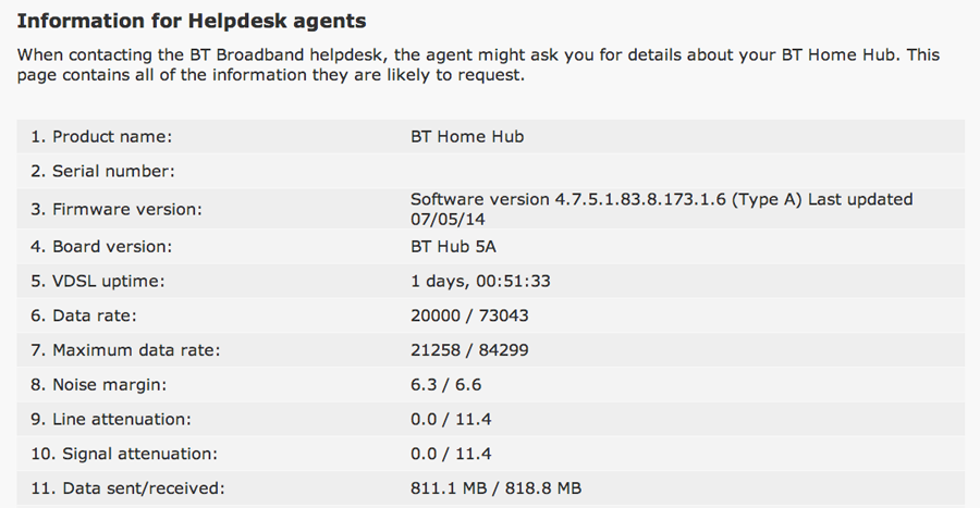

What are you syncing at with the exchange?
Check the router settings.
You will find it under help or helpdesk in the menu's, can't remember off the top of my head.  But you'r looking for something like this:
http://www.s-parker.uk/wp-content/uploads/2014/08/home-hub-5-helpdesk-screenshot.png
Let me know the data rate.
Thanks
aaronspence
Member
Hi there
Please see attached image

db's seem the same but the max rate is back up to 65mb which is close to what I used to get. Wonder what this means.

I should clarify just incase was misunderstood, whilst it says max rate 65mb, The actual speed is still stuck at 48 😞
