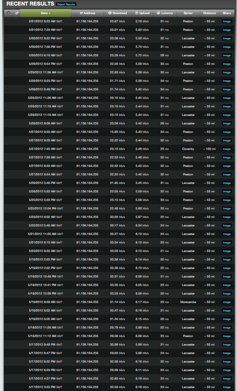

You are on an 80/20 connection!!!!, but the reason your speed is slow is because BT have capped your line rate because when it was running at 80mb it was throwing some errors on the line!
Obviously, we 'Discussed' this for some time!!!!
I asked when it was ever actually at 80, because i know it was only ever at 44mb, and i have done several tests every day, and it has never been any fatser than when forst connected, which was at 44mb, its never been at 80 as far as im concerned.
He said that they had reduced the speed on May 26th, but i think this is not true at all, if so we would have ssend a dramatic drop at this stage, and would have seen much better speeds previously!

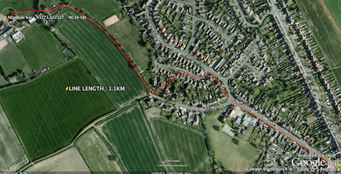

He also tried to tell me that the line length was over 3km from the Cabinet - WRONG!!
I have plotted the EXACT path of the line from the cabinet and have included a map, its 1.1km, NOT OVER 3km!!

Ooooops, didnt realise, i can view ok, ill try using jpg file instead of png, here goes:
Tried to post them as large as possible so you can actually see them!!
