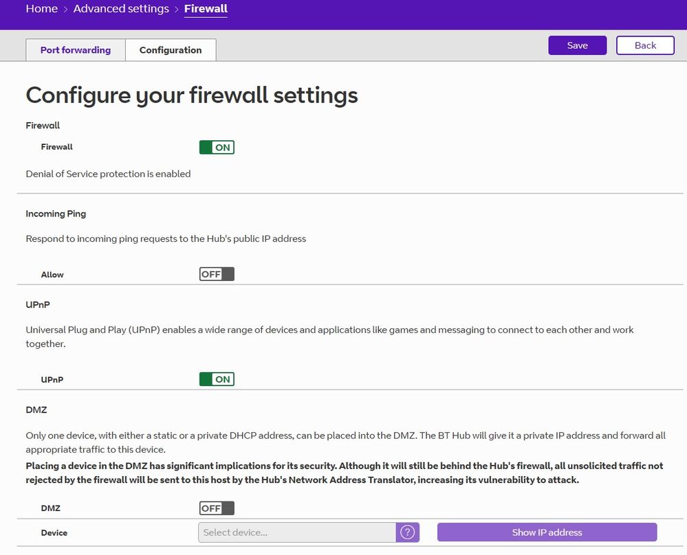

iand15
Member
Hi Beth
Thanks again for your reply.
Please show me where this information is ! My point above is that the option are not visible unless I am looking in the wrong screen - please see example attached....
Thanks
Ian
BethM
Administrator
Administrator
Hi iand15
Apologises, I was advised it would be on this screen. I will check into this and let you know once I have an answer.
