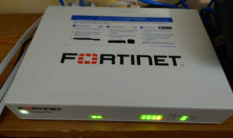

So we started from here: multiple land lines, ADSL broadband, a Business Hub in Bridge Mode, and a Fortigate wan interface connected using PPPOE. A very reliable setup delivering close to 70Mbit/sec.
We have ended up with 150MBit FFTP and Cloud Voice, running through the same Fortigate firewall with no Business smart hub. It delivers around 140Mbit/sec down and 30 Mbit/sec up.

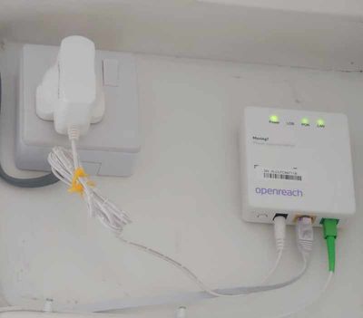

The OpenNTU is small but needs a power socket close by.
As we had so many holes drilled for the old copper, I asked for a fibre to run through an existing hole in a window frame to the outside box that terminated the fibre run from a telegraph pole. The three cables are power, ethernet (to fortigate), and fibre to the outside box.

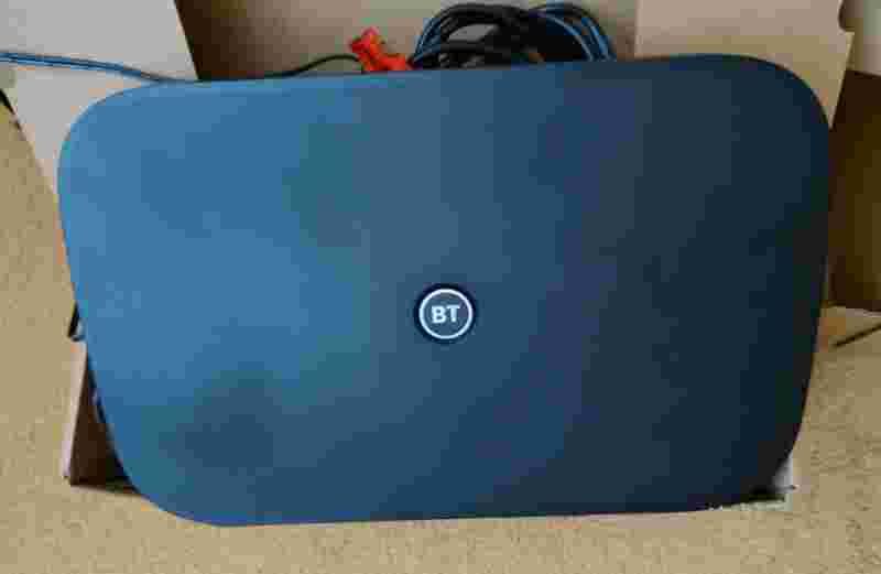

The BT Business Smart Hub requires power, and the supplied cable (Eth) is short so you need two power points for the NTU and Hub.

Once the Yellink phone was working, I removed the BT Business Smart Hub and ran a 30m flat ethernet cable (in trunking) from the NTU to my Fortigate. I kept the existing rule base for my internal network, just changing the WAN interface, and adding a new interface for the Yeylink Base unit.
Changing the PPPOE from ADSL with multiple static IP's to FFTP PPPOE took a few tries, and I learned to save the configuration before trying to connect. All my static routes and VIP's (Static IP range) were going (moved to cloud) and I was going to have a dynamic IP. And the WAN1 interface looks like this:

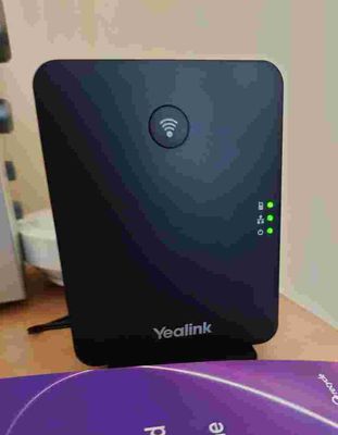

The Yealink Hub is shown below.

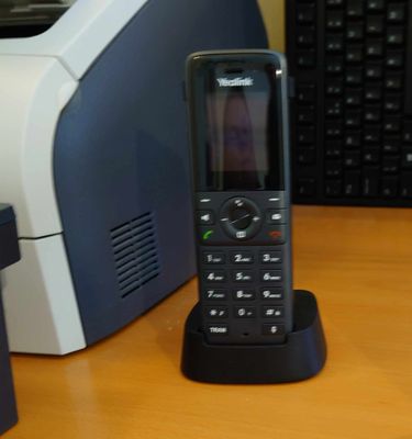

And the Handset has a separate charging dock.
The Yealink base is connected via ethernet cable to a separate interface on my firewall. The rule base follows the BT guide "BT Cloud Voice - Firewalls and LAN". On Page 4 there is a table of SIP and RTP rules to be implemented, on Page 5 (DNS and NTP) and on Page 7 there some rules for the Yealink Base station.
I also followed the Fortinet note on "Disabling SIP ALG on a Fortigate firewall".
I found the Yealink Base tries to dial home to an address that is not listed, but you will find that in the logs.
And finally here is the BT Business Hub disconnected and in its box.BusinessHub.jpg
