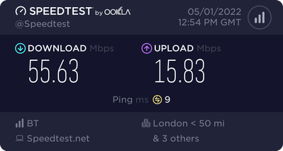

Speed test below is over IPv6 so the ping is low.

Hey, it was just a speed test my ping was 9ms, Download was 55.63 Mbps and the upload was 15.83 Mbps.
