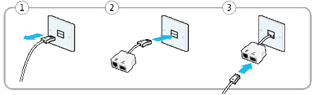

First, check that you have ADSL filters fitted.
Any devices (telephones, faxes, extension bells or monitored-alarm systems) that plug into your phone line need filters fitted to them.
  1. Unplug the device from the socket.
  2. Plug an ADSL filter into the socket.
  3. Plug the device you just unplugged into the ADSL filter's phone socket.
Diagram showing where to plug and unplug the ASDL filter.Diagram showing where to plug and unplug the ASDL filter.
