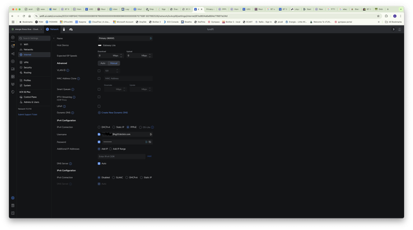

These are the basic GUI options on initial setup - If you go to the unifi controller there are further options (see attached screenshot)

I'm not sure if I'll be much help, but I have FTTC and when I switched to UniFi I had a USG3. I bought an old BT Broadband modem from ebay and plugged that into the incoming line, then the USG3 WAN port into the modem. I set the IPv4 Connection details in the UniFi controller (Internet -> Primary WAN in the controller) to PPPoE and added the generic bt login details under that and everything worked.
I can't take a screenshot as BT have just switched me to Digital Voice (still copper to the cabinet - I'm rural) so now have a BT Hub 2, but still have the UniFi working through that (although I've now switched to a Gateway Lite)
